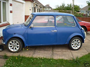

tak jsem si sehnal neco na zimu at se nenudim. je to mini neon 1991. popis byl takovy:
1991 Mini Neon. Unfinished restoration project. Many new panels including doorskins, A panels and wing. Small amount welding needed to boot. Brand new 13"Supersport Alloy whells with Supersport wheel arch extensions. ( old wheels and original Neon wheelarches also included).Stainless steel bumpers. Has been off road for past 3 years for restoration but prior to that in daily use. Will need mechanical attention before starting up. Paintwork needs completion as do headlights and associated electrics. A lovely car that needs finishing. Sadly have not got time to complete ourselves and space needed in garage. Buyer will need to collect.
Ve skratce. nedokoceny projekt, ma mnoho novych plechu a potřebuje dokoncit. po telefonu mi tvrdil že auto je bez koroze jen trochu v kufru.

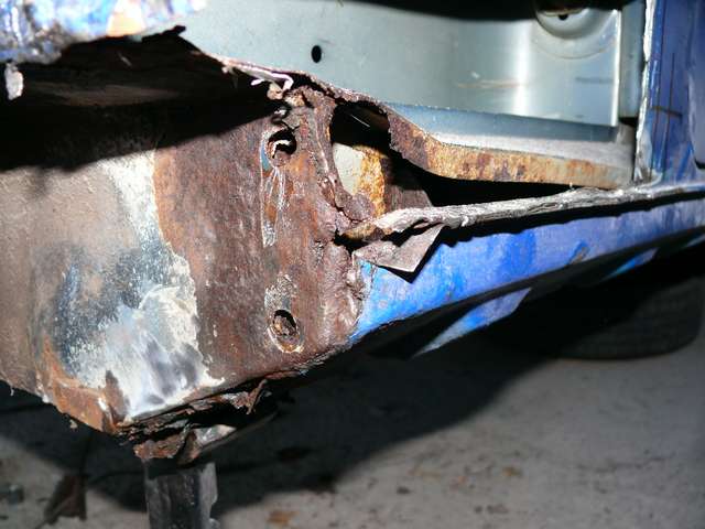

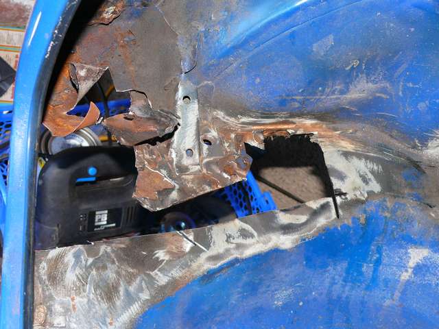

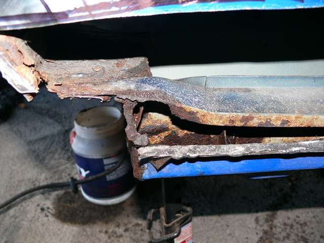

momentalne oběvuju poctivou anglickou praci (prahy přes prahy, navařit kus plechu přes díru a je to spravené, taky to co neni videt tak nerezavi (kapsy pod křidlama) atd..
přidavam par fotek a dalsi budou

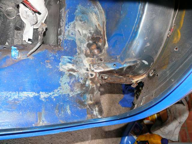

no zadek je skoro hotovy, až na kousek ( čekam na plech) a prahy sou a
ram in.

čau,kde jsi sehnal ty prahy?

prahy jsem sehnal na ebay.co.uk. občas se tam oběví ale 2 dny jsem je nahříval a tvaroval na auto.
